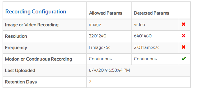

I received a message about exceeding usage so I deleted a bunch of files yesterday but there stilll isn’t any video or events available. What do I need to do?
8/11/2019 2:47:18 PM
CameraFTP offers "more than enough" (or "unlimited") storage space based on your subscription plan. Please make sure to configure your camera(s) based on your subscribed plan. In your case, your camera is uploading much more data than the plan you subscribed to. To find more details, please log on to cameraftp.com website, go to My Cameras page, then click the gear icon below your camera thumbnail. It will display Camera properties/settings page. You can find the camera parameters in this page. In your case, it is as follows:
To solve the problem, you can:
(1) Upgrade your subscription to video recording at 640x480, 2fps;
or
(2) Change your camera uploading parameters. Set it to: Image recording at 320x240, 1 image/6 seconds.

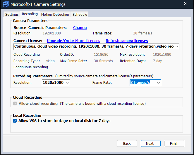

Somehow you configured VSS to record image snapshots. VSS can support continuous or motion-triggered video recording, as well as image snapshot recording. Please open VSS software window, hover your mouse on top of your camera live view, then click the Edit (pencil) icon. You can then change it to record video. Please see the screenshot below:
In the recording tab, select the (free trial) video recording license instead of the image recording license.
For more detailed information about VSS software, please watch the VSS tutorial video:
https://youtu.be/LuRtCBLvy4E
If you use a webcam as an IP camera, you can also watch this video:
https://youtu.be/okRD5Z2Gqso
