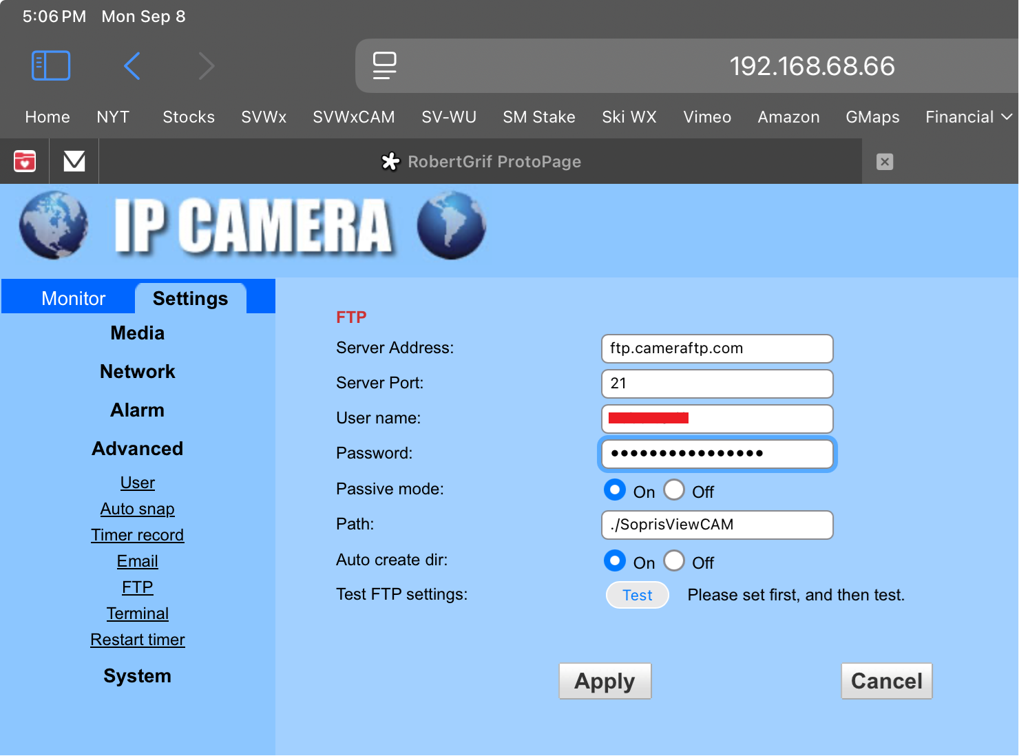

I just installed a new wireless network and I am relinking everything.  I'm having trouble with the webcam attached to your service. have a Ctronics CTIPC-550C-Z30 IPCAM.  I am accessing the camera through iOS Safari by typing in the static IP address.  Attached is screen shot of their FTP setup page.  The info on the page is correct.  I have Applied it and Tested it successfully.  And that 1 frame appears on CameraFTP.  But just that frame.
The problem is that a subsequent and current frame will not update once a minute like it is supposed to.  Can you help me?

Hi Bob, based on your screenshot:
The FTP information is correct; and you tested it to be successful. So it is not the FTP or our service issue. But please note that configuring the FTP information is just one of the several steps. In your case, it has proven that the camera can upload files to CameraFTP cloud, and that your FTP information is correct. The next step is to configure the camera to actually upload files to CameraFTP
This step is camera-specific. Based on your screenshot, please check in "Auto Snap" first. It probably has information about uploading image snapshots to the FTP server, usually you can set the upload frequency - which should be based on the service plan (Camera License) you ordered. If you have any questions, please feel free to email us the screenshots. If you cannot find it here, please also check in "Timer record".  ( Many IP cameras use "Record" to mean "video recording" and "Snapshot" to mean "Image recording". )  For users who ordered a motion-triggered recording plan, please click "Alarm" to configure motion detection and alarm/event recording.

 Hi,
Thank you for your help!  I am back online and the ftp is updating properly.  It was the Auto Snap feature that I didn't have enabled.  Thanks again!
